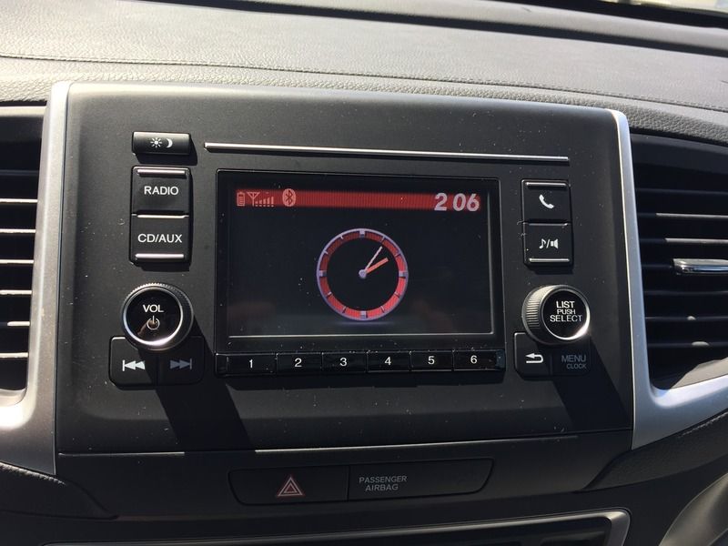

@rxitrxit I had a similar issue this morning and was able to get the base radio in an RTL to display the built in clock wallpaper. I had to select the clock wallpaper, then select wallpaper under display options, then push the day/night mode button and it displayed the wallpaper. I'm going to try some other wallpapers that I downloaded tonight.

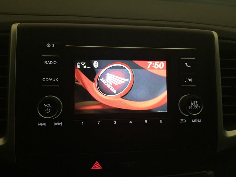

I tested out about 15 different wallpapers today. Got them all to display without issue. Decided on the one below. Started as 1920x1080, final resolution after resizing was 1365x768. Fills up the entire screen pretty well, which a lot of others that I resized didn't.
