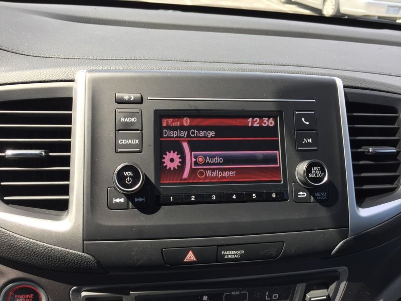

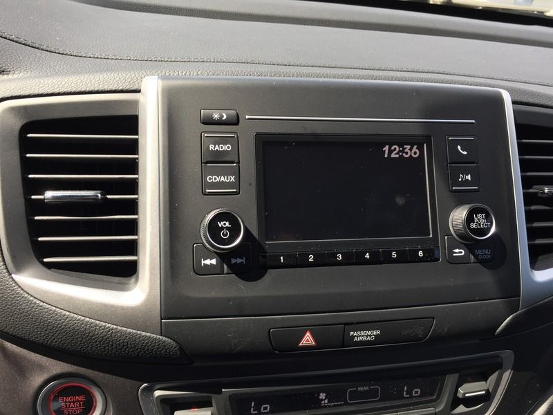

I was messing with the wallpaper options for the base radio just to see what they looked like. The only one stored from Honda is the clock, so I select it but it never shows a clock, just a black screen with the time displayed in the upper right corner. No biggie I'll just change it back to displaying the audio information except that I can't unselect the wallpaper now. I wanted to go back to just the audio information on the screen. I've selected audio under the change display in the settings, but it still shows the blank screen with the time in the upper corner. So my question is how do I get the audio information to display on the screen again??? What am I missing? I've read the manual and have been messing with the radio for probably 20 mins and can't figure it out. Help a brother out.
Thanks.
Blank screen mode:

Discussion Starter · #4 · (Edited)
Ok. After pushing all the buttons on the radio I figured it out. I had to press the day/night button (top left). This toggles between day mode then night mode then blank screen mode. It even displayed the clock wallpaper when I set it again. Geez Honda!
Edit: found at the bottom of page 204 of the PDF manual that it talks about the different modes (day, night, & off). I wonder if pushing this button "refreshed" the radio somehow to now be able to display the wallpaper.
