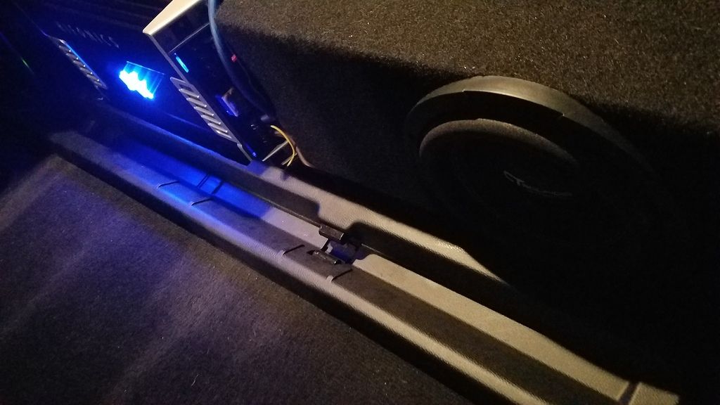

With less than 1000 mile I've made my first upgrade to my RTL. I have an affliction that requires me to modify everything. This car will be with me for the next 7 years so I decided I wanted to improve the anemic sound system.
I added two CT Sounds Stratos 8" woofers, a Hifonics 1500D amp in a custom box. The speakers are wired to 1 ohms and are taking all 1500 watts nicely. I'm far from high school age so these speakers are more than I needed but I didn't want to half azz the job. A little Bass Nectar and my rear view mirror was shaking. Stock head unit is still being used.

I had to recess the box after I made an amp change. The new amp was an inch thicker than original one I selected.

Very nice - box looks well made. I am more of a fan of sealed boxes but very well done.
Sub is my next project - one question for you. How did you route your power wire from the battery through the fire wall of the truck?

That's a slick custom setup and ported to boot. Nice work!

There's a boot located near top driver side which has a bunch of wiring harnesses running through it. I had to make a small cut and fish it through. I couldn't locate any accessible grommets.
