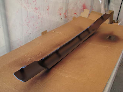

I purchased a Stampede VP Series clear bug shield from site sponsor http://www.realtruck.com/ and a can of paint to match my Dark Cherry Pearl Ridge from http://www.paintscratch.com/. I also spent a few extra bucks on the spray nozzle handle and it did make the job easier.
I used easy release painters masking tape to mask the front side to protect against overspray. In hindsight, I probably didn't have to mask it. It would have been just as easy to clean any overspray with alcohol but that had to be done before it cured (about 24 hours) and I was afraid of accidentally scratching the painted side. I cleaned the surface to be painted with dish detergent to remove any dirt, grit or greasy fingerprints.
I sprayed it in several very light coats, waiting 10 minutes between each coat. After the first couple of coats it looks blotchy, but resist the urge to fill it all in at once. Five to seven coats should do it, depending on whether or not you want it to remain slightly translucent. I gave it six coats and it is basically opaque. It probably goes without saying that the "rattle can" must be vigorously shaken between coats.
I was very pleased with the way it came out.

The paint should cure for at least 24 hours but 48 would probably be better depending on the humidity. The weather forced me to wait for 72 hours but it was all good.
The installation kit that comes with the deflector consists of 6 nylon inserts with 6 nylon washers and 6 phillips head screws. The only tool required is a phillips head screwdriver.
Locate the six square holes under the weatherstripping and insert the nylon inserts.
They just snap in.
Carefully push the mounting tabs on the deflector between the hood and the weather stripping and make sure the mounting slots are positioned over the nylon inserts. Using the nylon washer and the screw, attach the deflector, but don't tighten the screws yet. Lower the hood and make sure the deflector is centered. The mounting tabs are slotted so it will move slightly one way or the other. When you're satisfied with the position, tighten the screws until they are just snug against the nylon washer. Don't over tighten.
