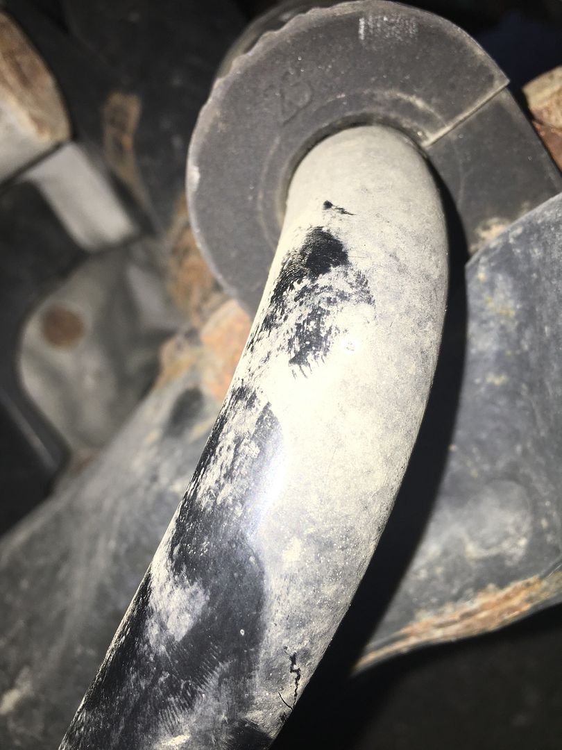

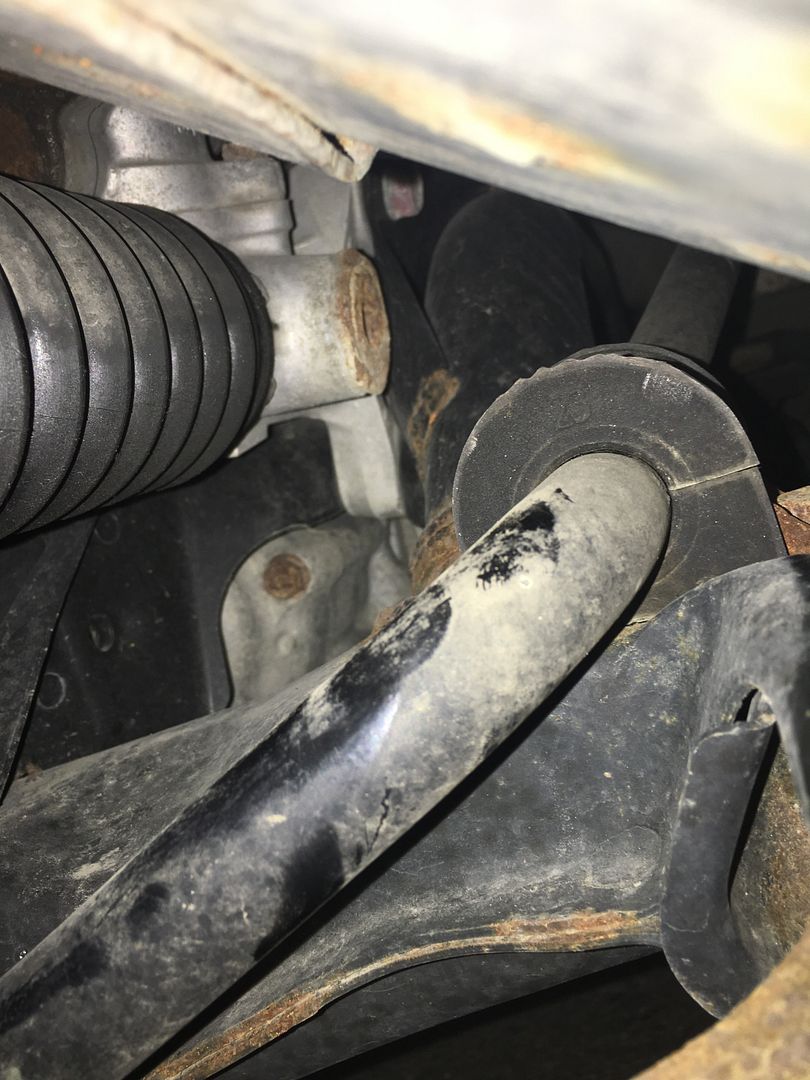

Just bought my used 2007 w 96,000miles. It was safetied less than a week ago, but I'm getting a big bad clunking sound if I go over manhole covers or other jarring bumps - drivers side front only, if it's a gradual type of bump like a smooth speed bump it won't clunk.
Am I right at assume/hope for front sway bar (stabilizer bar) bushings? I snapped some pics but it looks fine, is it possibly still culprit in spite of good looks?

Stab bushing looks fine. I'd suspect the strut bearing. You should be able to replicate by getting someone to rock the front end.
