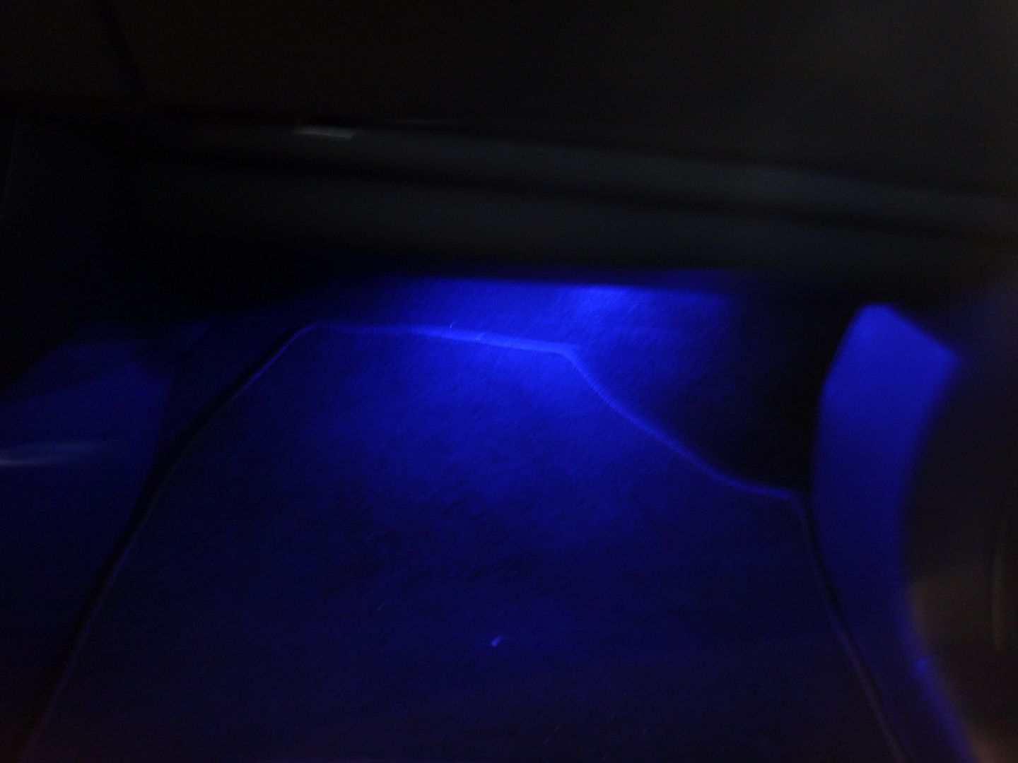

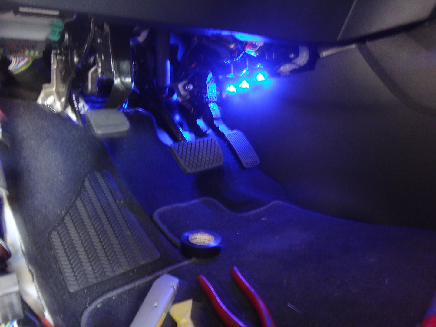

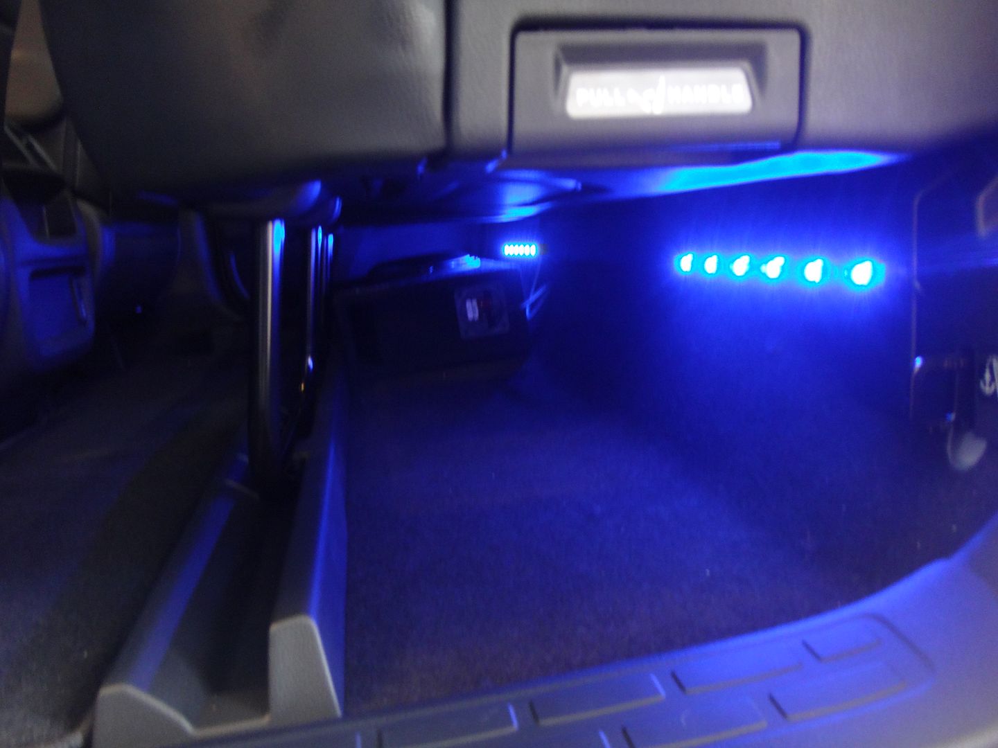

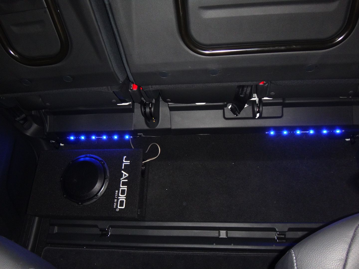

Get the starter kit and then a 6" add on kit. They are dimmable down to an extent. The lowest setting is probably all you'll need. They do 16 colors and it will remember the settings. Its the stuff as their Mosiac line sold for home interriors but its black instead of white and this is way cheaper, marketing. I put the 6" strips up front and 12" strips in back. Pay attention to the arrows as it says in the video. I got one reversed and had to find where i did it.
I put a three foot cable across the front from driver to pass then a 5' and a 3' or something to the rear and then another 3' across the back. I used electrical tape to hold the connections together. I started on base of the plug. Do that or shrink wrap. Clean your surfaces with alcohol so the strips stick.
