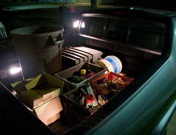

Let there be MORE cargo lights. I always wanted more lights for the cargo trunk. I changed to LEDs but still wanted brighter.....well this is brighter. Enjoy!!
Let us know if anyone else tries to do it.
Here's how they normally look with LEDs.
Here how mine look now.
Here is how i did it
60 Posts
Discussion Starter #5
Put the lid back on....held it in place and seal with the silicone you see in pics.
60 Posts
Discussion Starter #7 (Edited)
Yup, got those adapters. Its the 5k ones. I've been thinking about doing the same for the other cargo lights but the main ones that would benefit are the trunk ones so i did those for sure. It was a fun project.

Actually you should try those products first. Just because it's written on the interweb doesn't mean it's automatically true. Sometimes you need to interject your own logic to see if it makes sense instead of blindly believing what is written on a Web page. In this case about 40 leds facing in one direction should have more light output where you need it than 4 or 5 leds in all directions.
2,554 Posts
I have them and the 95 lumen from each of the bed and trunk locations is more light then you could need.
In the reflector housing all light is directed toward the bed area. You need to remember that 40 bulbs putting out a combined 84 lumens won't be brighter than a single bulb putting out 94 - especially when in a small area. I'll take pictures soon so you can see the brightness.
60 Posts
Discussion Starter #19
Good post up some pics, I might use them for the front cargo lights since the housing isn't a good size or shape for these.
