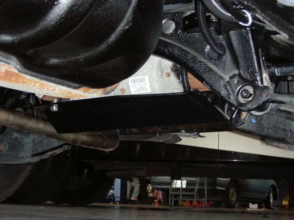

Made a rear Differential cover today.
So I had a 2007 RL come in today so. I made this with help from a long time friend. I'm very happy with the fit and its very strong. let me know what you think.
One of these and a one of my skid plates and you are set. These are ready to ship.

Nice fabrication, Cad plated hardware too. Should be a few folks here that want a little protection on the diff. Pricing?
4,589 Posts
A two bolt mounting system?!?!?!?!?!?...at least thats how it looks to me. Maybe I misinterpeted the pictures. Also it looks like you welded a bracket for the rear mounting bolt.
While I'm not saying it won't work, your front cover was much better.
Thanks, not sure what pricing will be.
No there are three mount points. The drivers side has a kick up that bolts to the subframe. The rear bracket was there and has been on every one i have looked at.
I will work very well for the job its made for.
Well set me up.:act024:
Burtman will have them as soon as I have pricing and production.

Do you have a picture of the 3rd mounting point? I'm having a bit of difficulty in locating it myself. I'd like to see it before I place my order.
Rusty, the bracket you see is the rear center jacking point. It is standard on all Ridgelines.
PS. I like the wrap around idea on the skid plate. The SCORE Baja Ridgeline skidplate doesn't even have this feature. It appeared to me that if you would back up, the skidplate would snag whatever was under the truck.
Edit: I know TMac posted a picture of the SCORE Baja rear skidplate somewhere back at the end of 2006. I can't find it. I looked for it for about a half an hour. Any of you old timers remember where he posted this picture or have a copy of it?
there is a steel strap with three holes in it, that goes between arms off of the subframe. its hard to get a photo with it installed. RL is gone now. I will work on getting a better shot.
Ej. I guess you wont be needing my RL for a template any more when I come up by in August.
We can still get you done, just let me know when you are coming to town.

Does the rear diff cover protrude into where the rear diff drain is located? I couldn't quite tell from the pictures.
It does. but I did not see the scene in putting a hole. it would have weaken the plate and for three bolts it left it covered.
