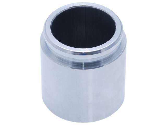

So i measured the OD diameter of the fresh out of the box OEM rotors with a mic, and I'm getting 46.3mm. So, like your findings, they are not lining up w/ Centric's data.
However, the portion of the piston inside the caliper could be larger than the actual portion that makes contact with the pad. I've never removed a brake piston so I can't confirm, however an quick google search shows that some some piston designs are have smaller diameter heads and larger diameter bodies...
However, based on your measurements, that's still 6.3mm larger than your measurements...
I'm hoping your 46.3mm is the Caliper, unsure if that's the front and from which possible vehicle, MDX, Pilot, ZDX or?
This measurement is the outer diameter of the pistons from the MDX front calipers I purchased. Again..which based off the image below, doesn't mean anything. The portion of the piston inside the caliper can be larger than the portion that makes direct contact w/ the pad.
Either way they are still larger than the 40mm Ridgelines' based on your measurent. Now if only we could confirm the Pilots'.
