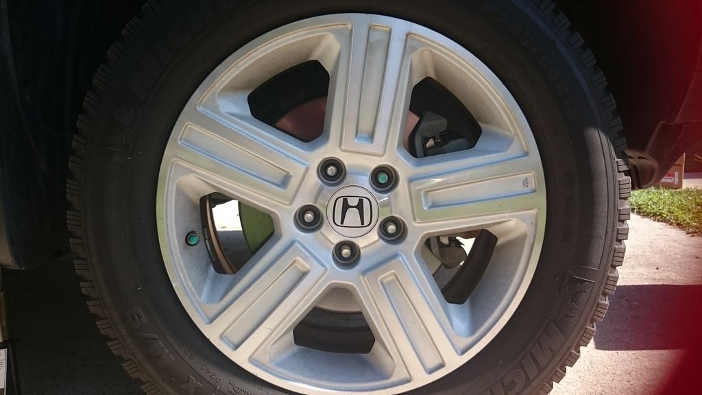

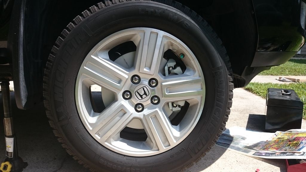

Before:
After:

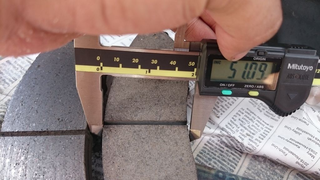

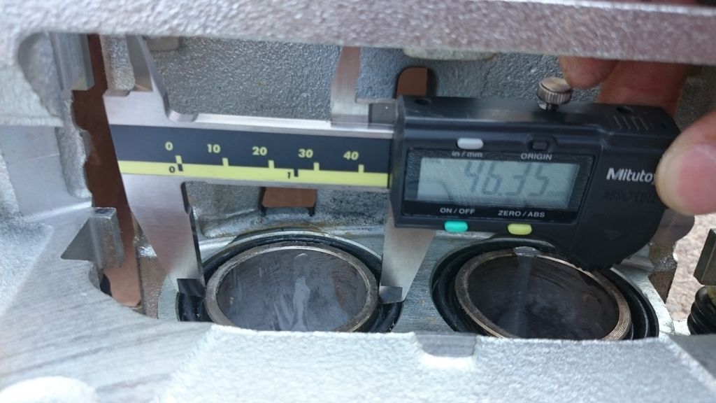

Ridgeline Front Brake Pistons Mic'd at about 40mm:
MDX Front Brake Pistons Mic'd at about 46mm:

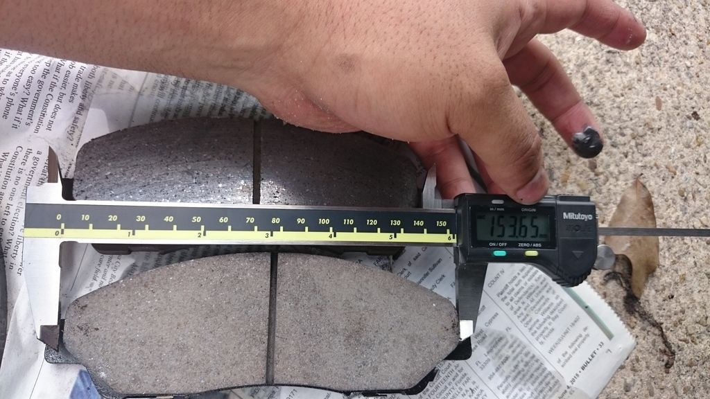

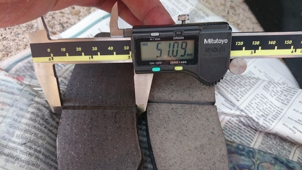

MDX vs Ridgeline Brake Pad Height (they're the same):

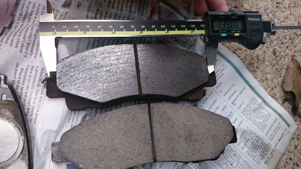

Ridgeline Pad Length (139mm):
MDX Pad Length (153mm):

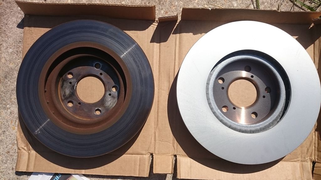

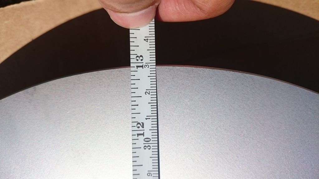

MDX Rotor Diameter about 13":

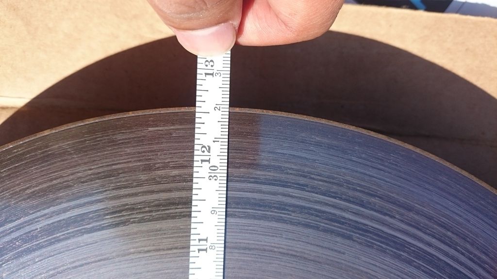

Ridgeline Rotor Diameter about 12-5/8":
Side by Side Comparison of Rotors:

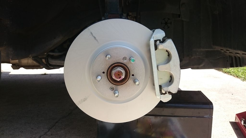

New OEM MDX Rotors, Pads & Calipers Installed:

Are both of those measured pads the same Mfg/model?
I'm just wondering if the difference in length profile is from the different car model, or if it might just be different mfg variation?
I can only assume what was on the Ridgeline since those were installed before I purchased the truck, however the mdx one's are oem. Regardless, the pads are designed to match the contour of the calipers. It's possible that there may be a few millimeters in variance between mfg... But not a 14mm difference.
You might be surprised.... if an aftermarket mfg knows they can make one common pad to satisfy multiple applications, they certainly would consider the economies of scale when defining their "replacement" version product.
While I don't doubt that, the mdx simply can't fit inside the Ridgeline caliper.
I would say that is EXTREMELY UNLIKELY that the observed size differences are related to different pad manufacturers. Bigger rotors with larger calipers and matching larger brake pads. End of story . . . .

Looks good and thanks for the pics and details. Did you replace the brake lines as well?
Feelmuhpino,
Thanks! Too bad the new rotors lost their nice shine after the initial break in process. No, I didn't upgrade or swap brake lines. Just wanted to understand the gains from a simple direct bolt on "upgrade" using oem parts. Although I'm only about half way through the bed-in process I can tell that there is a huge improvementa in braking ability.
If I could do it again I would recommend purchasing the brake "splash guards" of the vehicle's rotors and calipers that you plan to swap. Not necessary, but I only have about 2-3mm of clearance between the guard and the rotor. I haven't run into any issues with it after about 100 miles of driving, so...not required, but for about $30 more it is recommended.
Well that settles that! :)
