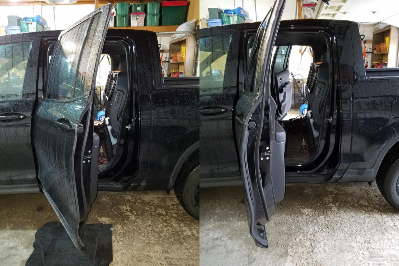

I increased the rear door opening by installing a set of front door stops/ checks on the rear and it works perfectly. No rubbing or conflicts of any sort.
P/N Left: 72380-TG7-A02 (replaces 72380-TG7-A01)
P/N Right: 72340-TG7-A02 (replaces 72340-TG7-A01)
