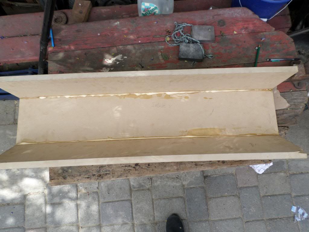

Test fitting
Front, Back, Bottom piece glued and screwed
Test fitting top piece, found out that the back piece (angled piece) was a little curved, not a straight piece of wood.
Putting blocks to try and get it as close as possible to be straight
Putting glue in the gaps

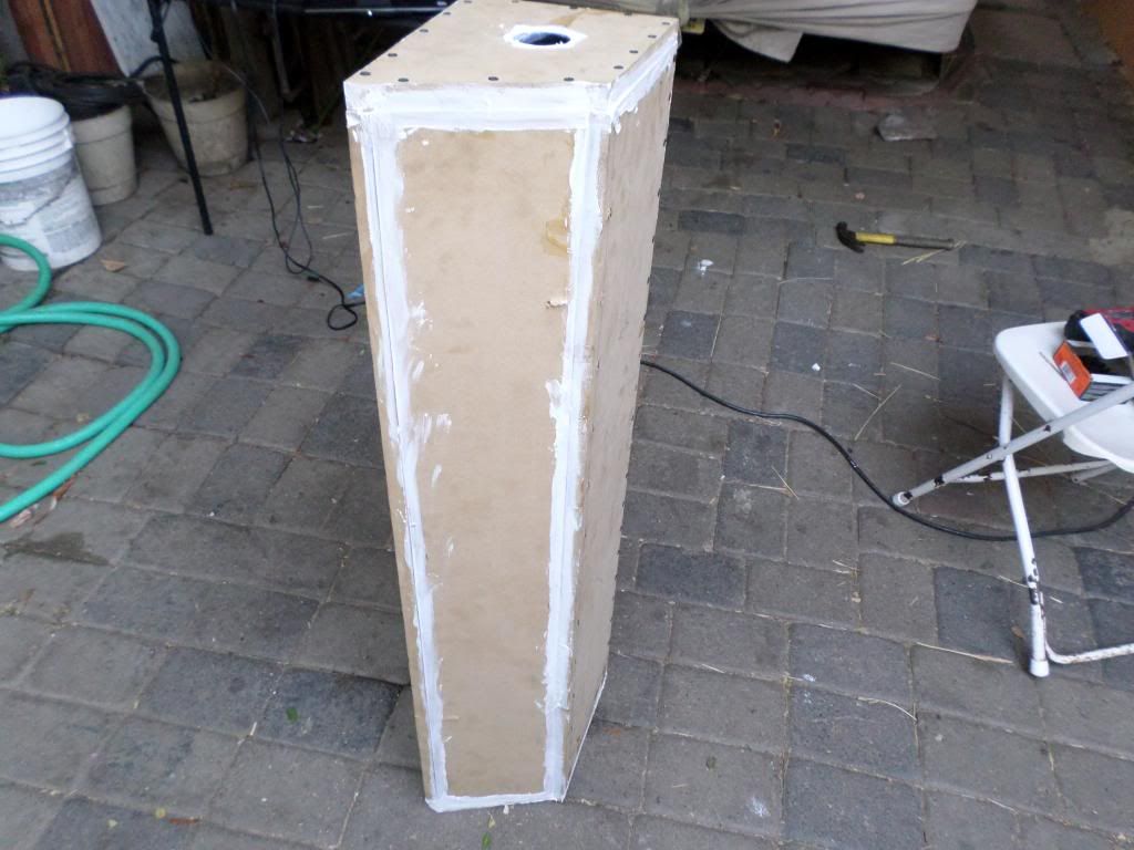

Pre drilled screw hole for alignment
Whole for aero port
Everything screwed and silicone to prevent air leaks and rattles
