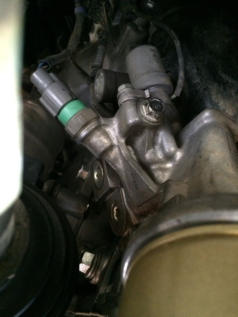

*UPDATE* Pretty bad oil leak from rear main seal 08 with 103k miles..Any ideas?
Hi guys, I have an oil leak from the area pictured. It seems like its coming from the inner side next to the two allen bolts and its hard for me to get a good visual. The oil drip would travel straight down and pool up around the oil pan bolt. Any help would be great!
4,180 Posts
That's the spool valve assembly. There's a gasket between it and the block. Plus an o-ring around the oil pressure sender.
http://www.hondaautomotiveparts.com...tcgry4=KA5AT&catcgry5=OIL+PUMP+-+OIL+STRAINER
Your mechanic can remove that and replace them.
But first, check under the oil filter to make sure there's only one gasket there. Sometimes they stick during an oil change and you can end up with two, and it'll leak.

Thank you for the help. I am pretty sure its leaking from what I believe is the Oil pump assembly. I ran my fingers to the left of the allen screws on the assembly and I can feel sludged oil. Is there a specific spot that is prone to leaking? I really wish I could get a better visual on whats going on.

Yes if its the spool valve assembly it should be easy :D . I think if its the oil pump assembly next to the spool assembly the timing belt has to be removed according to some posts Ive read. I'm crossing my fingers that this is not the case! If it is leaking at the oil pump assembly I could have had it fixed for cheap during the timing belt service :act060: . I added some UV dye to the oil so I can get a better look at what is going on.

You are correct... the oil pump is under the timing belt cover.
