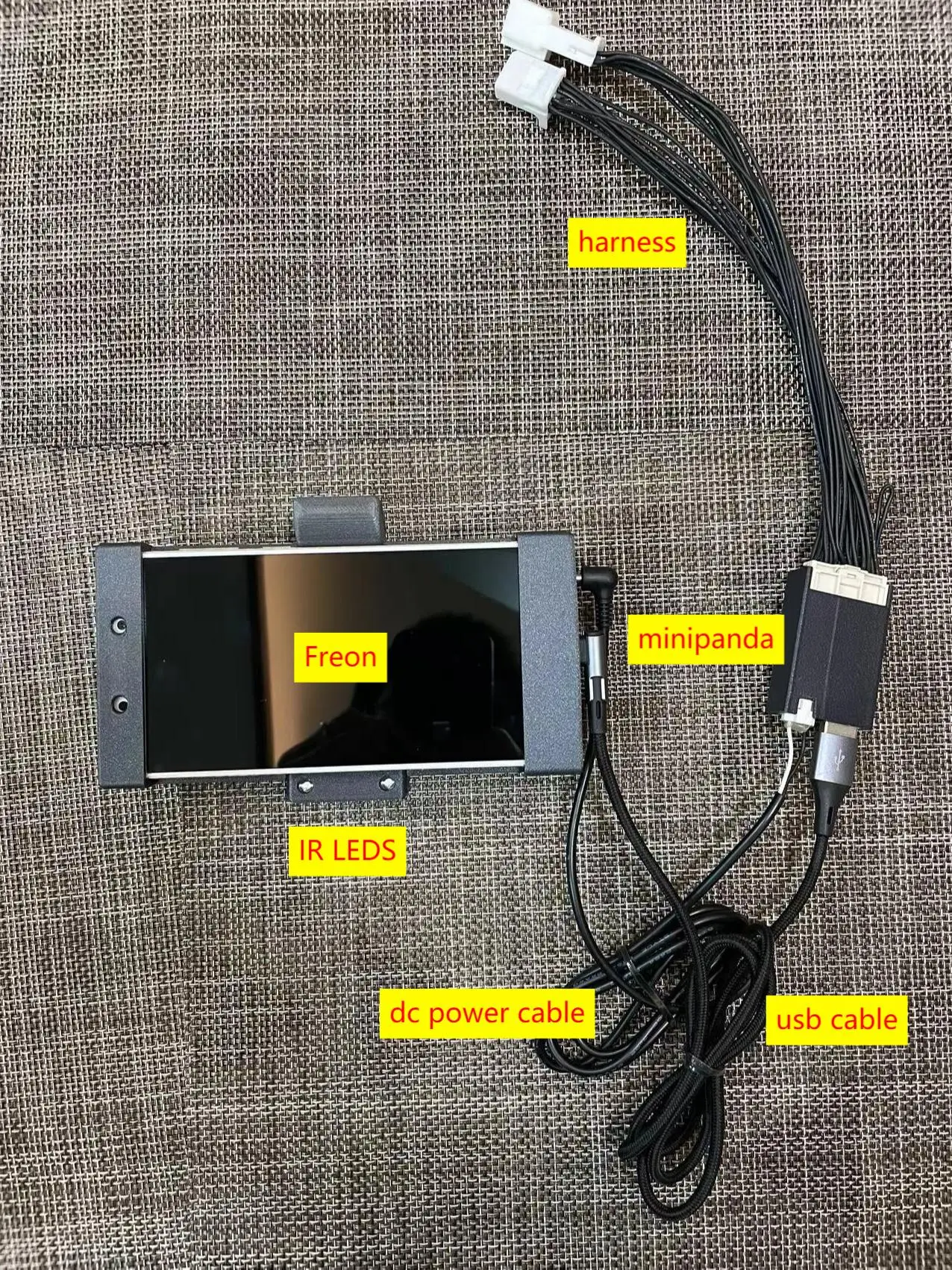

I'm happy I found this thread, I was about to order from Comma.ai but saw folks mentioned Openpilot kit for HONDA NIDEC from aliexpress. The product doesn't seem to be available on aliexpress anymore. Is there any other vendor for it or is it best to just bit the bullet and get Comma.ai? I will definitely be installing the pedal as well. Those of you running it, what's the best source to get more info on it. I understand Comma.ai is shipped blank.

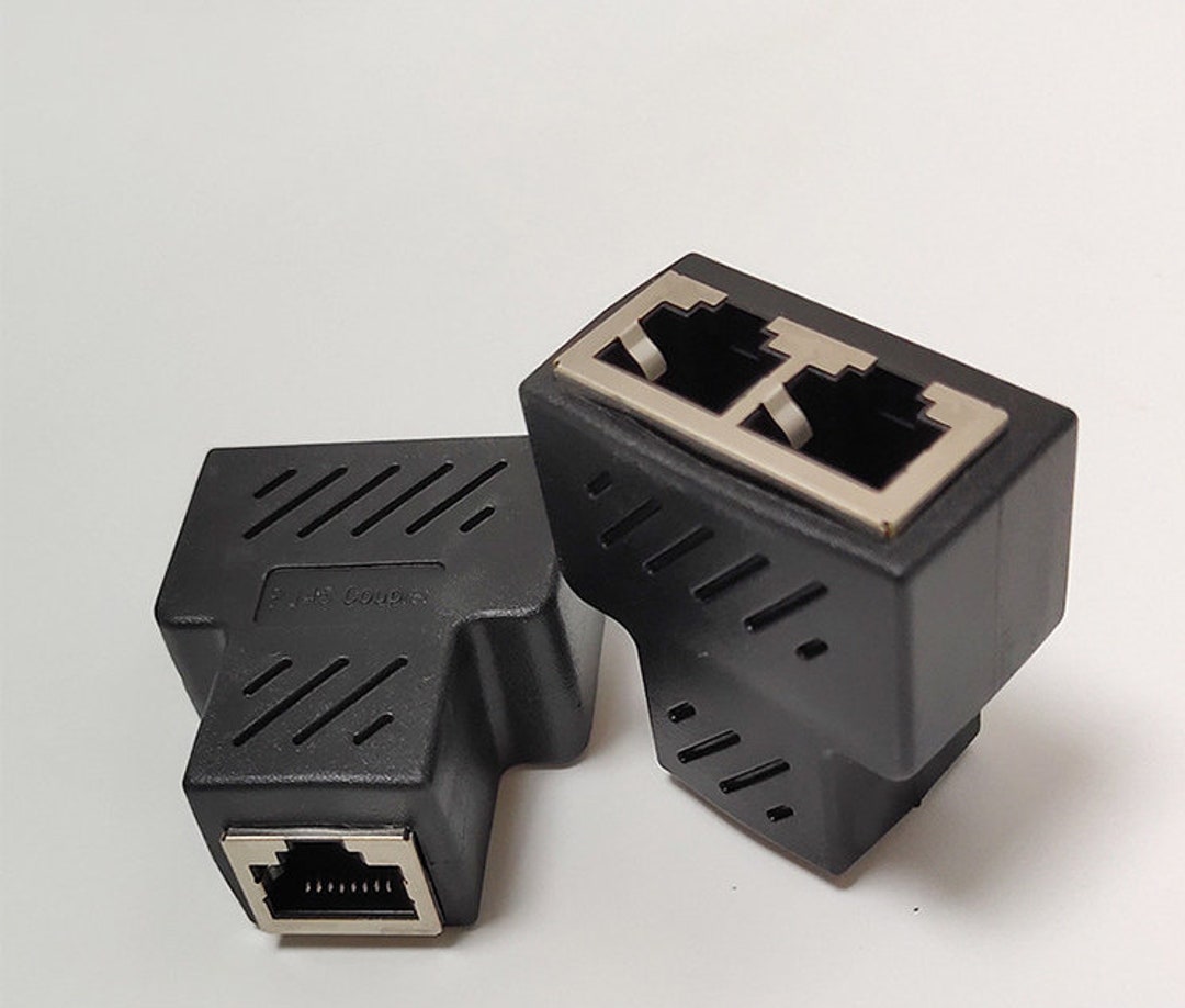

for both the C3 and the cheaper one, to have the car control braking down to 0mph and back up, you will need two things.
This splitter.
and this "pedal"

I did get the pedal and splitter from that bear fella on Etsy as well. Were you able to use any cat5 Ethernet cable? I'm hoping to have everything ready to go as soon as the comma arrives, without having to wait on any extra bits. I believe I'll still need about 6ft of Ethernet from the pedal area to the comma, and maybe a foot from the pedal to the splitter?
It’s funny you ask, I bought all different lengths of cable (Amazon Basics) and they worked great… I can’t remember exactly which length went where… Let us know how you make-out… Cheers
