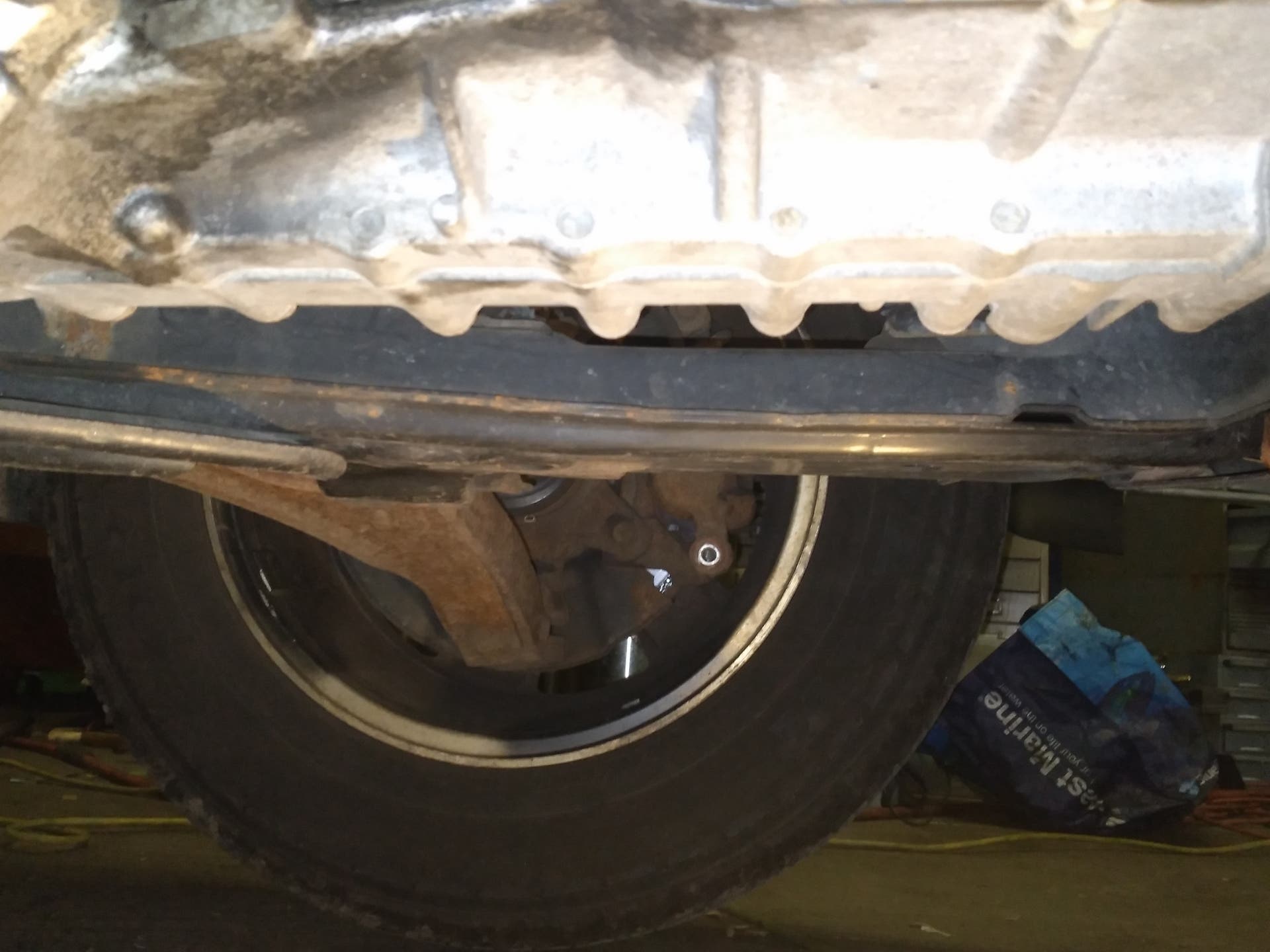

I guess I botched something because my friend mechanic told me last night that I lost a bottom caliper pin/bolt on the driver (front?) caliper. I consider myself lucky that this didn’t end up bad.
Anyway, does anyone know how to find the specs or part number for this bolt?
I understand it’s an option to take the bolt out of the other side and get the specs, but here are some possible options for me I will consider:
  • buy a bolt from a parts / JY RL.
  • buy some used calipers with the bolt(s)
  • buy new calipers if they include this bolt/pin
  • get the part number and buy a bolt and buy it online
  • find someone on eBay parting one out and send them this picture and ask them to send me a bolt.
I’m just looking for the simplest solution. New calipers might be smart because mine look like they were on the titanic.

Honda part number is 90107-S0X-000
Found on 99-04 Odyssey, 03-08 Pilot, and 06-14 Ridgeline.
Simplest solution would be to just go do your Honda dealer parts desk and pay the $3-4 for it.
DO NOT replace it with something from the hardware store.
