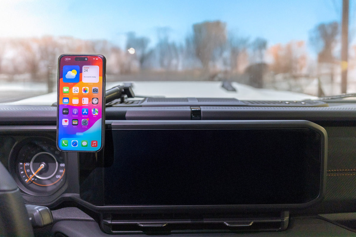

I did a modification to the ProClip mount. I really like the MagSafe system, even though I have an Android phone. I just put my phone in a MagSafe compatible case and it charges great. I mostly like the ProClip mount, but I think it puts the phone too low (blocking the vent) and a little too close to the steering wheel. So I cut the factory ProClip mount off of the ProClip base and fabricated my own plate that moves the phone.
Anyhow, here's how it turned out:
More info here:
