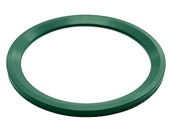

The ZF 9-Speed drain and fill plugs have integrated gaskets. I realize that you're supposed to replace them at each fluid change, but I didn't see that as necessary.
Interestingly, the sealing washer on the lip of the plugs has a DIN number:
"DIN 3869-18-FKM-dt"
DIN 3869 is a standard D-shaped washer. FKM is the material (Viton). 18 may indicate a size 18 washer. I wish now that I'd have grabbed my dial calipers and measured the washer for confirmation but this may be the exact washer at $13 for a 10-pack:
Otherwise if it's a size not available on Amazon, there are lots of standard sizes of this washer available for about 45 cents each, plus about $7 shipping.
Anyway, considering they want like $30 for one drain plug, just replacing the rubber washer on an otherwise fine plug seems like a very economical solution.

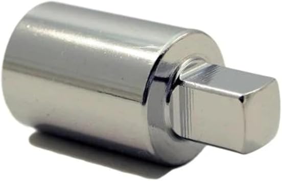

My brand new 10mm square drain plug tool is the wrong size. I bought this tool:
I had read that the fill and drain plugs are NOT 3/8" square, but actually 10mm square. People had posted that a 3/8 drive will fit into the plug but it'll be a little loose and could increase the risk of stripping out the plug. So I bought the 10mm adapter. Well, in my case the adapter doesn't fit at all and a 3/8 extension fits perfectly in the square drain plug hole. So I don't know if Honda changed plugs somewhere along the line or if the rear diff is 10mm or what. But anyhow, I ended up just using a short socket extension on the transfer case which worked great. The plugs were pretty tight, but I had a 3/8" to 1/2" adapter on a long 1/2" ratchet which broke them loose pretty easily. I did not bother to replace the crush washers and instead just cleaned them and put them back together again.

I also read on ROC that 10mm fit the rear differential plugs which is not the case.
Luckily I got this set instead of the one socket since we have four vehicles in the fleet.

Nope 10mm doesn't fit the rear differential plugs. I read that also but luckily I purchased a set since I have Subies and a Toyota in the family fleet.
The 3/8" square plug socket in this set I purchased fits tighter than a 3/8" extension. That will keep you from rounding the plug fitting. Which I had done to my 1st Gen using extensions. Also handy if you have other makes of vehicles as I.

You are correct on the DIN spec for the transmission hydrolic seals. The 18 doesn't necessarily mean 18 mm diameter. That is the 15.7mm ID in viton as you had found on Amazon. I looked into this recently and debated putting a 40K mile washer kit together for fluids for my new Gen2. Unfortunately, to get a really good price you do need to buy in bulk. The best price I found was for a lot of 100 and the (pre-shipping) price was about 30 cents each.
