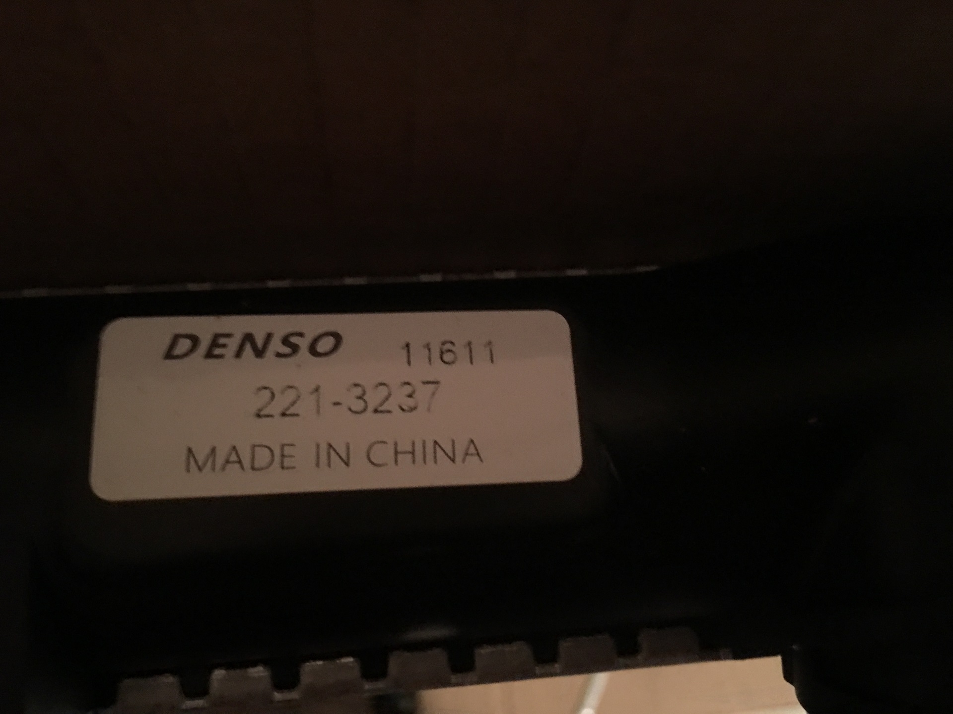

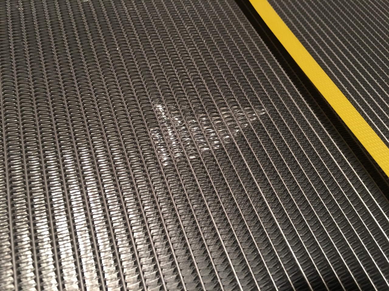

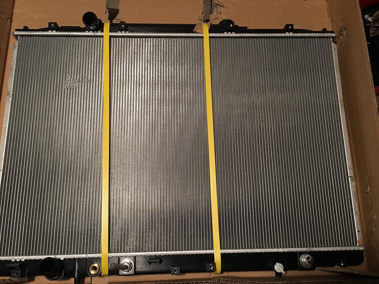

I just received my Aftermarket Denso Part Number 221-3237 (Acura MDX 3.7L and ZDX 3.7L Only).
Sooo can you spot the shipping damage? For 40 bucks shipping I would expect better of RockAuto.
Luckily seems that the cardboard piece that was crushed inside was the source of the bent fins while in transit. Doesn´t seem to be any real damage, just cosmetic.

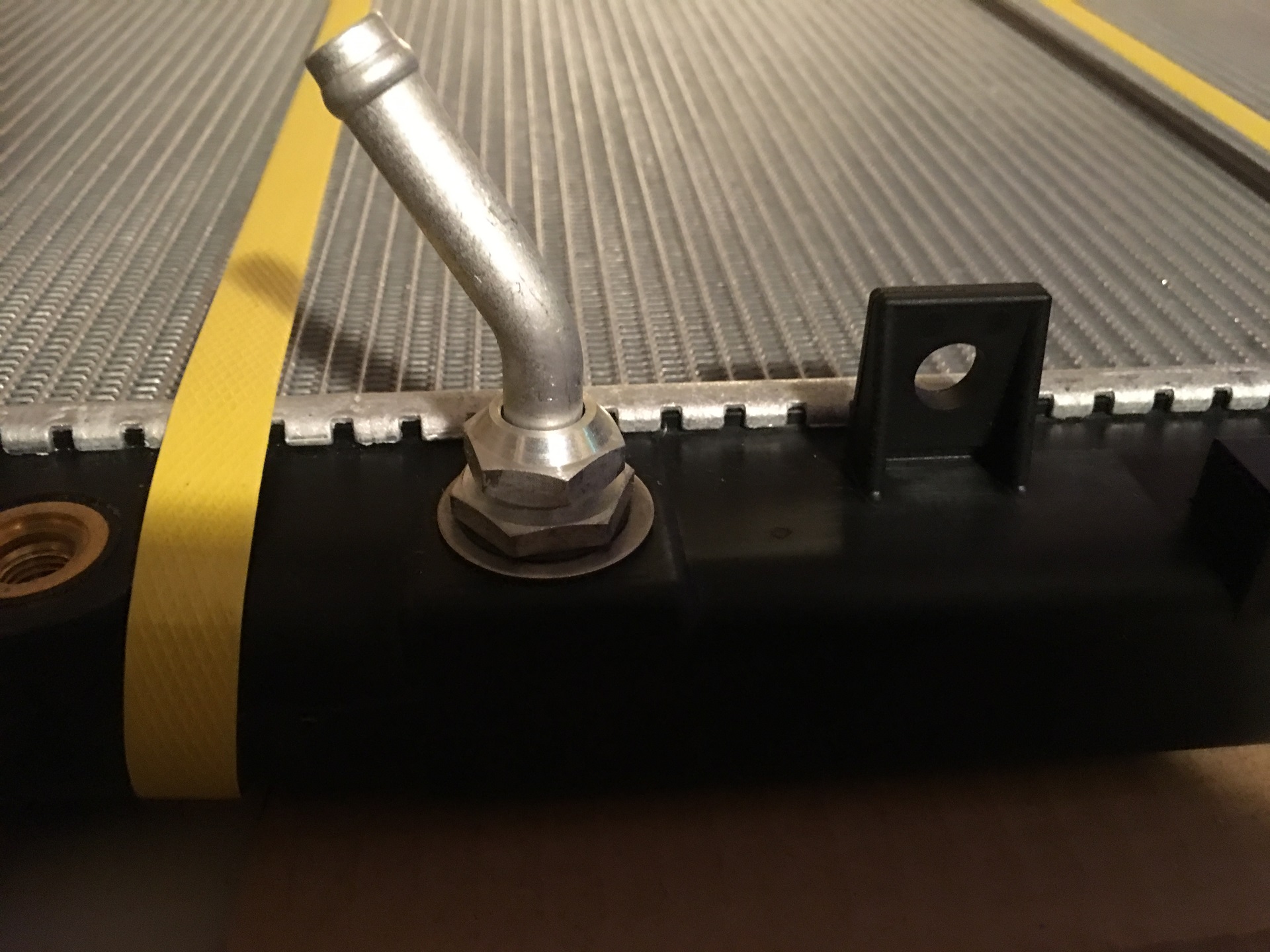

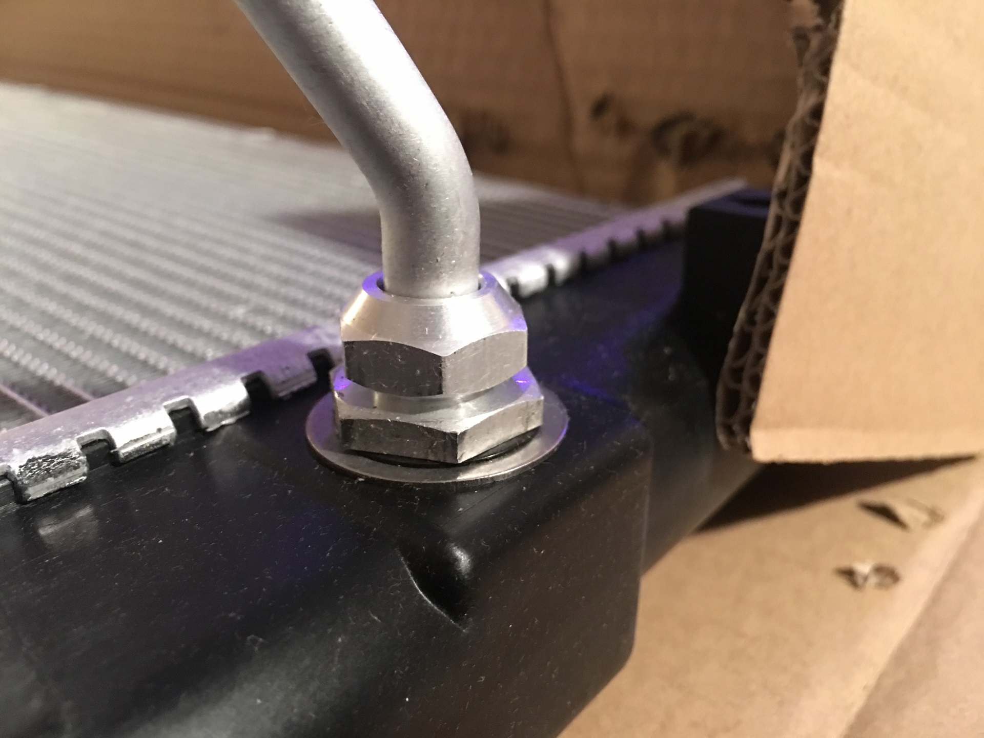

ATF Warmer Inlet and Outlet Tubes are Definitely not the same as OE these are similar to the other Aftermarket Units:
Made in the good´old PR of CHINA!
