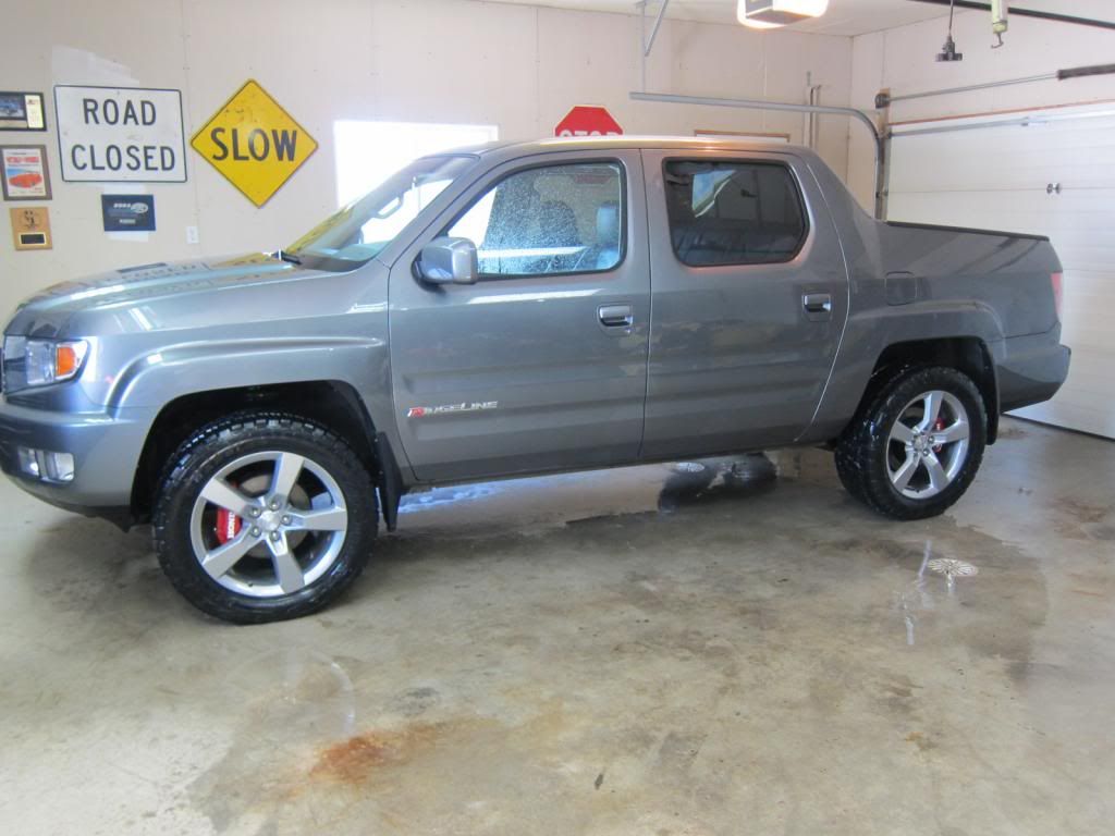

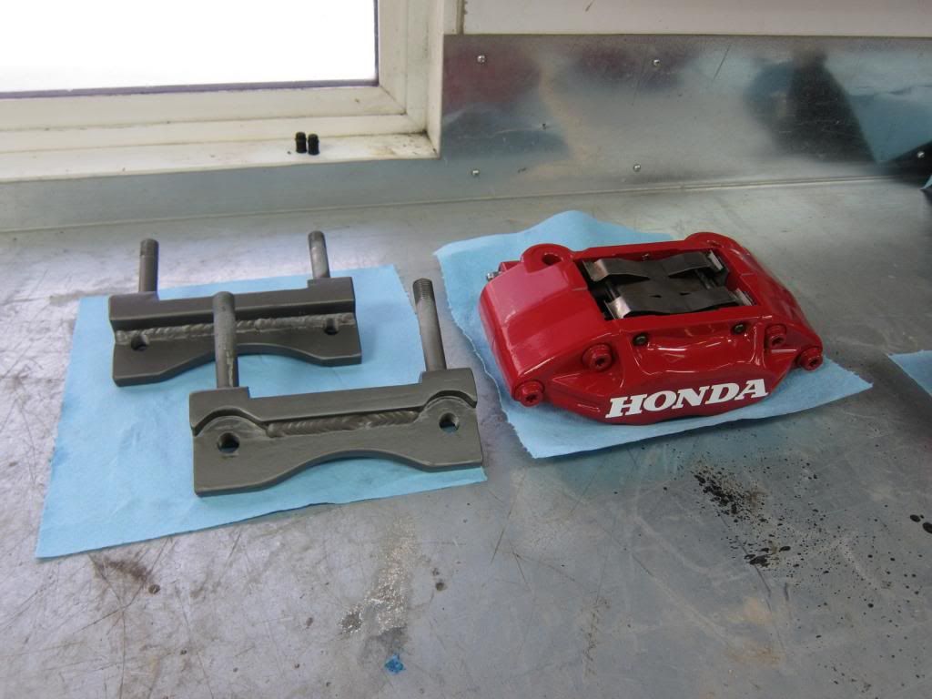

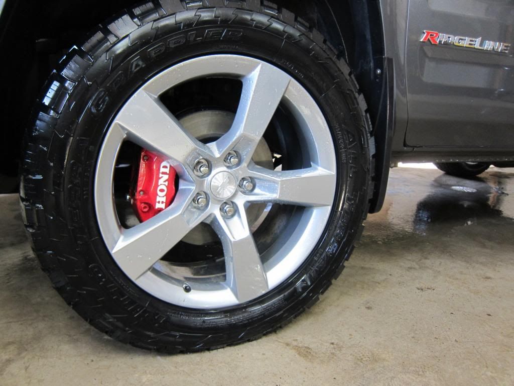

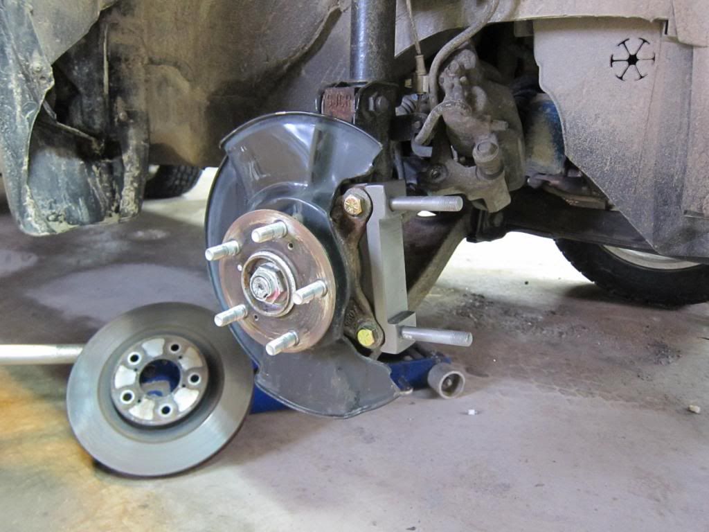

Finished it today...Acura RL front calipers grafted onto my RL...stock rotors which are the same as the Acuras.
Had to make some adapters, machine a saddle into the calipers - used the stock Acura lines/hoses and it's working perfect.
I didn't have to modify any of the stock set up...I could go back to original in minutes. No changes to the backing plate even.
Definitely more bite than the stock ones.

It definitely feels much better...more agressive and responsive. It's been just one day so I'll report again later.
And yeah the rotors do look small in there now!
