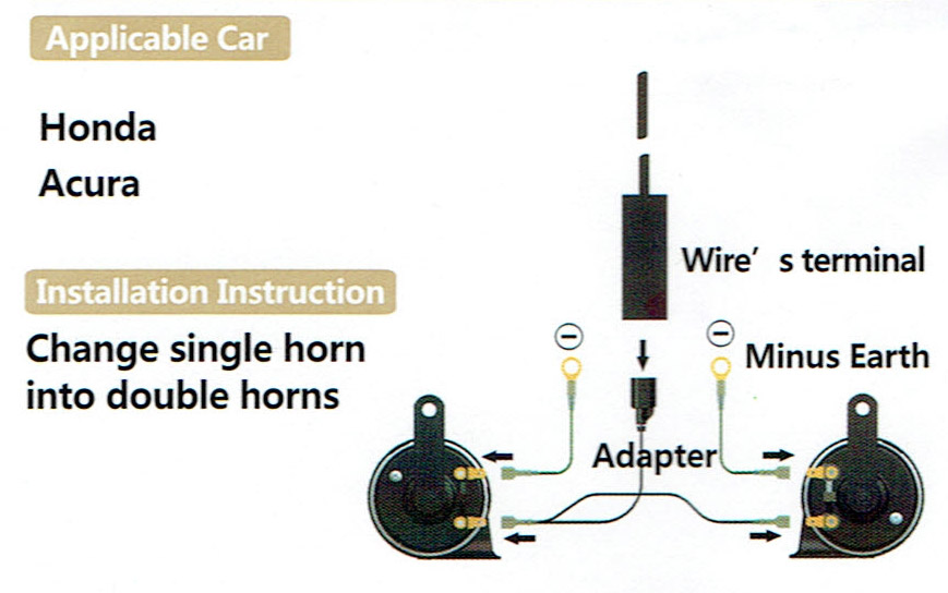

I upgraded my Ridgeline horn less than a month after I bought the truck...people just smiled and waved because it sounded 'so cute'. :rolleyes: PIAA's Superior Bass Horn package is pretty much a plug and play unit; College Hills Honda sells a splitter wire that allows you to connect from a 1-horn to 2-horn assembly without any splicing. Works perfectly with the 12V system. Listen to the difference in the videos on Amazon's reviews. It turns your Civic into a 70's Ford Esquire Wagon.:ROFLMAO: Makes my Ridgeline much more noticeable now, and people actually move back into their lane with wide-eyed looks.
I like the sound from the reviews I saw. Didn't notice your review. How long have you had them installed? I see some experience premature failure.
What is that wiring kit needed for?

I installed them in July of 2018. I made a custom mounting bracket that fit in the same area as the original, and used the wiring kit to hook them both up. The single connector goes to the factory harness, and you attach the other ends to the power tabs on the horns. The other wires plug to the ground on the horns, and the loops/washers are grounded to the truck.
